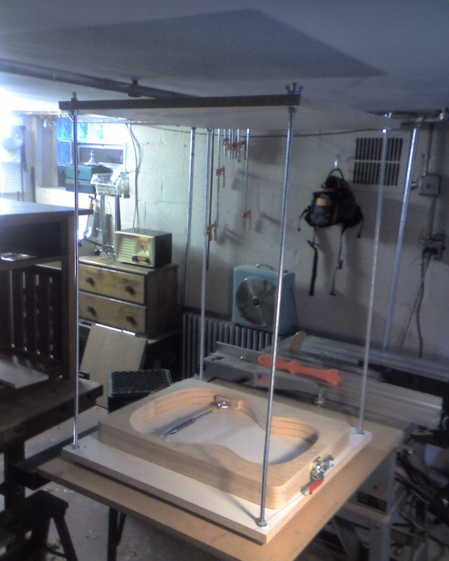

Well, here is the fruit of today's labor. A new go-bar deck is done and I have started making inside cauls for holding the sides in one of John Hall's molds. Next week the wood and parts will arrive and then I have to start my first build. It is going to be a kit, but I want to do a little customization, like wood bindings and a couple of other little things.
The deck might not be robust enough (3/4" thick) so I might have to glue only a few bits on at a time. What do you think? Any advice for my maiden voyage? Thanks in advance!

Steve, nice deck bro!
Just a friendly advice though, you might want to make it a full inch thick (2 X 1/2" thick layers) at the top and at the bottom also, you do not want the top or bottom parts to flex under pressure while glueing anything in there and also for security reasons, i wouldn't want my bro to receive a flying rod through the belly!
Other than that Steve, it looks great!
Oh and what a neat shop you got, are you related to Hesh?
SergeSerge Poirier38962.8227314815
PostPosted: Sat Sep 02, 2006 10:40 am
Looks good Steve. I would suggest that you get some 1/2 inch PVC pipe to cover the threads on the side supports. It will prevent accidents where you might scar the wood and actually increased the stability of my go-bar deck. Your off to a good start and I'm looking forward to seeing your build.

Man, I've heard of 'deep bodies'-it must work for the dimention next to ours.

it looks great,
Like Don said....get some PVC tubing from home depot to cover the threads on the side supports and it will look better and be a lot sturdier. I think you are fine a 3/4 plywood.
To me it does look a little too tall....is that a reasoning behing that?

It's 36 inches tall. I read somewhere that 24" was too short, and the rods don't flex much at only 24" long. Fortunately, mine is adjustable! What is the average deck height?

If it's of any use, I used 3/4" metal conduit to cover/support my threaded rods, and a 32" deck height. Personally, I think 36" is just fine.
But yes, if possible, I would up the thickness to at least twice what you have. Looks really, really good though.

As has been said, get some PVC... You'll find the top starts to move around while you're putting in go-bars and you'll accidentally launch them into all corners of your shop all of a sudden. Don't ask me how I know that.
I've been using 24" and it's been just great so far with 3/16" fiberglass rods.
PostPosted: Sat Sep 02, 2006 11:51 am
Remember that at 24" after you add the radiused dish plus the height of the braces you'd be getting a bit more flex...

Steve, i hope you are not too discouraged by all the advices or suggestions that were given on your first jig, we all know you felt proud of making your very first lutherie jig, the crticism you have encountered here is the only way we have to make sure you remain safe and that your jig will help you succeed properly but i'm guessing you already knew that eh bud!
Listen to the group's wisdom my friend, i know it made me make giant leaps in my lutherie skills!
Your mold is awesome and the shop seems to have great karma if i can borrow Heshter's words!

It looks like you have used melamine for the top and bottom boards. Is that so? You may find that the surface is very slippery and your rods may not "bite" into the surface very well. If you have some other board kicking around, I would switch to something a little "rougher" or just add a second board of a different variety, even basic plywood for the top will be fine, but you really want a surface that will hold the dish in place when you start adding pressure, the whole thing could "explode" out of there and you wouldn't want that.
If the plates are some other type of material that is not slippery, well just disregard all of that .
As others have said, there is a lot of pressure on the top plate when you a gluing down a full set of braces, even on a back. I would add a layer on the top or if you don't have a piece to add, you can add some "braces" on the top side of the top. Use 1"x2" screwed to through the 3/4" plate to stiffen up the entire top plate. Make a simple + on the top will add a lot of stiffness and you will not see much flex in the plate at all.
That's it though (other than the pipe over the all thread which many others have noted).

Thanks, Rod. Yours sounds like the best solution/mod. I am going to add a plywood layer to each of the inside surfaces of the upper and lower plates.

Just remember, lots of screws will make it like one piece no need to glue it together here IMHO.

BTW, the extra height of your deck means that the go bars might need to be stouter. Longer bars will give you less force than shorter ones of the same dia.

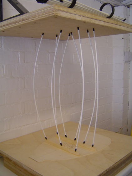

Steve, it does look a bit too tall for my liking, I use 24" 3/16" fibre glass rods and they flex just fine, you only need about 1"-1/1/2" of flex for clamping. To get the height of the top above the base add the dish depth and the total body depth of your guitars (assuming you want to use the go-bar for gluing top and back). When gluing braces make a raiser block to sit the dish and plate in. You may also find a bit of flex with just 3/4" top, add another layer to stiffen it up.
This is the deck I use, I used heavy duty angle-iron brackets so that the front was clear allowing more convenient access.

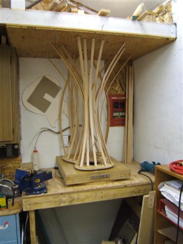

My deck is similar to Colin's but the top of mine is the underside of my loft space.
Here's a look
